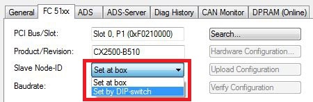

- 1. Click on the CANopen device in the tree view on the left.
- 2. Click on theFC 51xxtab and select the option Set by DIP-switchunder Slave Node-ID.

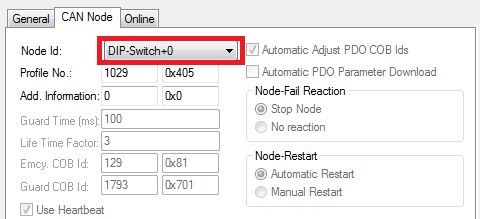

- 3. Click on the CANopen box in the tree view on the left.
- 4. Click on the CAN Node tab and select the option DIP-Switch+0 under Node Id.
In this example the number 0 is added to the address set on the DIP switch. Other numbers (0-126), e.g. for virtual slaves, may also be added to the address.
