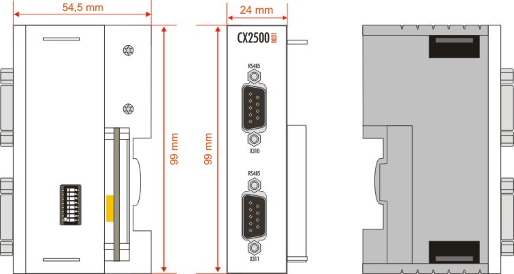

The system interface CX2500-0031 expands a CX20x0 by two serial RS485/RS422 interfaces.
Technical data
CX2500-0031
Interfaces
2x D Sub RS485 / RS422
Power supply
via system bus (via power supply module CX2100-0xxx)
max. Power loss
1.2 W
Current supply
500 V (supply/internal electronics)
Electrical isolation
500 V
Dimensions (W x H x D)
24 mm x 99 mm x 54.5 mm
Weight
approx. 203 g
Operating/storage temperature
-25° C ... +60° C / -40° C ... +85° C
Relative humidity
95% no condensation
Vibrations/shock resistant
conforms to EN 60068-2-6 / EN 60068-2-27
EMC immunity/emission
conforms to EN 61000-6-2/EN 61000-6-4
Protection class
IP 20
