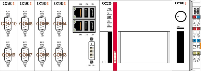

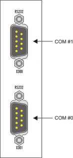

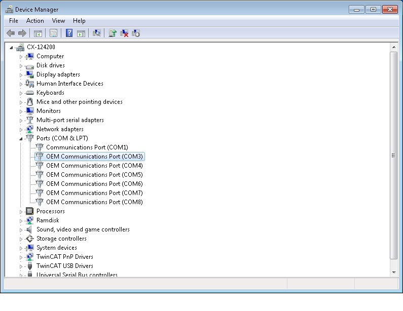

In the operating system the interfaces are numbered from right to left (starting from the CPU) and from top to bottom (i.e. X301 -> COM n and X300 -> COM n+1 for n ={ 3, 5, 7, 9}):

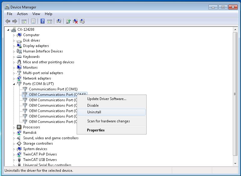

If the interfaces configuration is changed, the numbering of the interfaces changes. To obtain unique interface numbering, we recommend to delete the interfaces manually from the Device Manager.

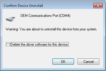

To do this, select Uninstall from the context menu.
In the following dialog the driver must remain in the system. The box must not be ticked.

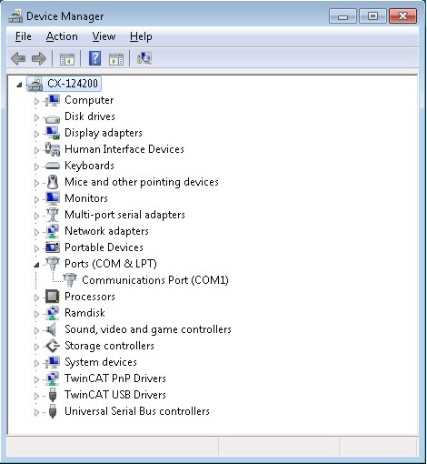

Once all serial interfaces, apart from COM1, have been removed in the Device Manager, the system can be shut down and de-energized.
The hardware configuration can now be changed. Once the configuration has been changed as required, the system can be restarted. The operating system restarts and numbers the interfaces as described above.
