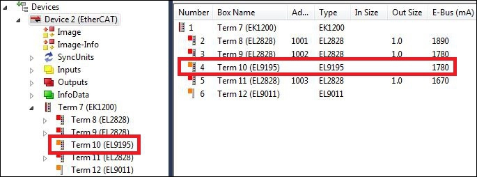

Passive EtherCAT Terminals (e.g. EL9195) can be detected in TwinCAT. In the tree structure the EtherCAT Terminal is displayed without process image, and the value in column “E-bus (mA)” does not change, compared to the preceding EtherCAT Terminal.
Installing passive EtherCAT Terminals 2:Fig.6: Identifying a passive EtherCAT Terminal in TwinCAT.
