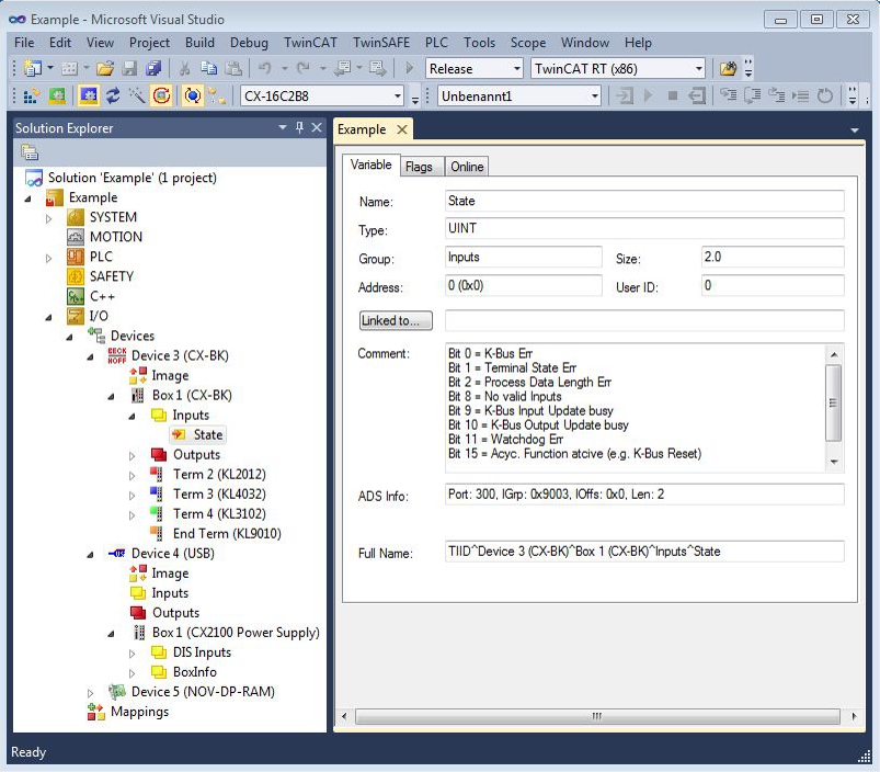

State variable
In TwinCAT there is a State variable under the bus coupler for K-bus diagnostics.
K-bus 2:Fig.10: State variable for error handling and diagnostics under TwinCAT.
If the value is "0", the K-bus operates synchronous and without error. If the value is <> "0" there may be an error, or it may only be an indication that the K-bus cycle takes longer than the task used. In which case it would no longer be synchronous with the task. The task time should be faster than 100 ms. We recommend a task time of less than 50 ms. Typically, the K-bus update time is between one and five ms.
Description of the State variable values.
Bit
Bit 0
K-bus error.
Bit 1
Terminal configuration has changed since the start.
Bit 2
Process image lengths do not match.
Bit 8
(still) no valid inputs.
Bit 9
K-bus input update not yet complete.
Bit 10
K-bus output update not yet complete.
Bit 11
Watchdog.
Bit 15
Acyclic K-bus function active (e.g. K-bus reset).
If there is a K-bus error, this can be reset via the IOF_DeviceReset function block (in the TcIoFunctions.lib).
