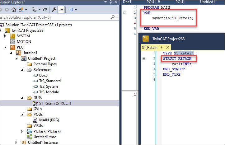

If self-defined data types (DUTs) are used as retain data, the data types must be available in the TwinCAT type system. To do this, the structures must be created directly as STRUCT RETAIN, with all occurrences of the structure then handled by the Retain Handler.
Creating and linking variables 1:Fig.33: Labeling with keyword STRUCT RETAIN for self-defined Data Unit Types (DUTs)
Retain data cannot be used for POUs (function blocks) as a whole. However, individual elements of a POU can be used.
Prerequisite for this step:
Create variables as follows:
1. Create the variables in your PLC project in a VAR RETAIN area.
Creating and linking variables 2:
2. For self-defined Data Unit Types (DUTs), use the keyword STRUCT RETAIN.

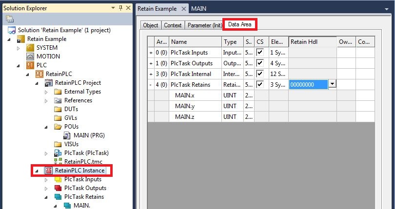

4. Click on your PLC Instance in the tree view on the left and then on the tab Data Area.
Creating and linking variables 4:

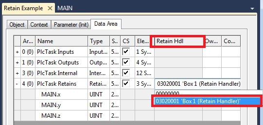

5. Under Retain Hdl, select the Retain Handler that you have created.
Creating and linking variables 5:
After selecting a Retain Handler as the target, the symbols are linked in the tree view and a mapping is created.

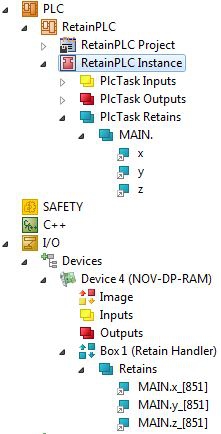

In the tree view, the PLC variables are created under the Retain Handler and linked to the PLC instance variables.
Creating and linking variables 6:
An existing link is indicated by an arrow icon.
