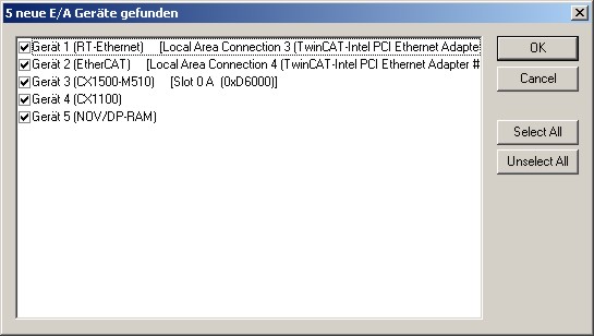

The module CX1500-M310 (master connection for Profibus) can, as all other modules of the CX-system, be accessed via the TwinCAT System Manager. The user selects the desired system and search for units in the System Manager (click with right button on I/O Units - this operation is only available in config-mode) After some seconds the connected units are listed. The user selects the devices he / she wants to make use of in the program.

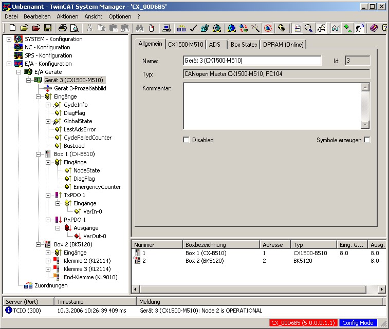

In some cases not all boxes can be found. Restart scan to find the missing boxes. If there are still boxes missing please check cables and operation mode of the boxes (the mode should be operational) If two or more devices on the bus have the same node-id none is found. Change the node-id and scan again.  If the scan is complete the founded boxes are shown:
 m_devices
The status of the CANopen bus is shown in the upper region of CX1500-M310 entry. The programmer can connect these signals with variables in PLC to analyze them in the program (e.g. error codes for saving states or registers). Below "BOX1" is a status field (NodeState, DiagFlag und EmergencyCounter)) for transfer diagnosis. Next are the input / output signals. The tree shows the Process-Data-Objects (PDO) that are created in the process image of the salve module. The variables can be accessed by mapping them to the PLC program. The direction represents the view of the slave: inputs are read by TX-channel / outputs are written to the RX-channel. If the box is a bus coupler (see Box 2)  the available bus terminals are displayed.  The number of the box represents the bus address . In "Free-Run-Mode" of TwinCAT the bus function can be checked easily: Just force a signal by "write online" and see if the control LED ion the terminal lights up.
If the PLC project is loaded the signals can be connected with the variables by double click in signal. (For further details see documentation on TwinCAT). The connected signals are marked by a small arrow on the signal icon. If all signals and variables are connected the new configuration can be saved and loaded onto the CX-System. The PLC program is started via PLC control.
