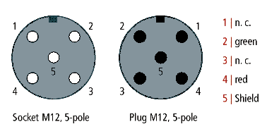

M12 socket pin assignment (-B310)
M12 socket/plug pin assignment (-B318)

PROFIBUS conductor colors
PROFIBUS conductors | M12 | D-Sub |
B red | Pin 4 | Pin 3 |
A green | Pin 2 | Pin 8 |

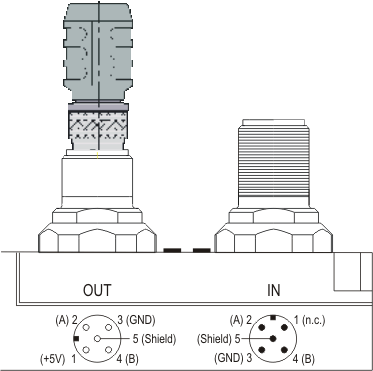

Connection of Fieldbus Box modules
The connection of the Fieldbus Box modules is done direct or via a T-piece (or Y-piece).
The B318 series does have a male and female connector, that means no external T-piece is required. The supply voltage (+5VDC) for the termination resistor is only supplied via the female M12 connector. The termination resistor ZS1000-1610 is only available with male connector.
Therefore the incoming PROFIBUS line should end in a female connector.
Two T-pieces are available:
- ZS1031-2600 with +5VDC on male and female connector for the termination resistor
- ZS1031-2610 with +5VDC only on the female connector
