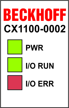

CX1100-0002 power supply LEDs
After switching on, the power supply immediately checks the connected Bus Terminal configuration. Error-free start-up is signalled by the red "I/O ERR” LED being extinguished. If the ”I/O ERR" LED blinks, an error in the area of the terminals is indicated. The error code can be determined from the frequency and number of blinks. This permits rapid rectification of the error.
Display
LED
Meaning
CX1100-0002 power supply LEDs 1:
Power
Power supply
The LED lights up green when the power supply is correct, but red if there is a short circuit.
I/O Run
K-Bus diagnostics
The green LED lights up in order to indicate fault-free operation. "Fault-free" means that the communication with the fieldbus system is also running.
I/O Error
K-Bus diagnostics
The red LED flashes to indicate an error. The red LED blinks with two different frequencies.
The I/O error LED blink code
