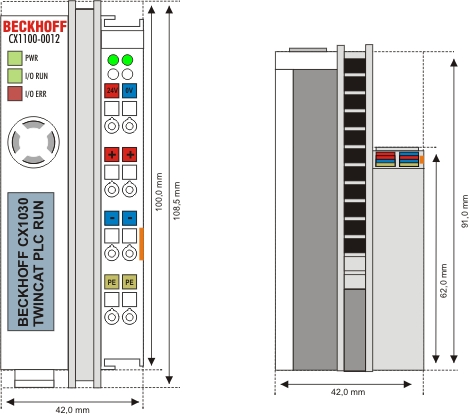

Technical data CX1100-0012
Technical data |
CX1100-0012 |
Power supply |
24 VDC (-15%/+20%) To meet the UL requirements use a 4 A fuse or a power supply that has to satisfy NEC class 2!
Dielectric strength |
500 Veff (supply / internal electronics) |
Max. power consumption |
3.5 W |
Recommended fuse at 24 V |
4 A |
K-bus connection |
yes (adapter terminal) |
E-bus connection |
IP-Link connection |
K-bus power supply to |
1.75 A |
connection type |
Cage-Clamp (adapter terminal) |
NOVRAM |
8 kByte |
Display |
FSTN display 2 lines x 16 characters of text, illuminated |
I/O-DPRAM |
2 kByte |
Diagnose LED |
1 x PWR, 1 x I/O Run, 1 x 1/O Err |
Dimensions (W x H x D) |
42 mm x 109 mm x 92 mm |
weight |
app.250 g |
operating/storage temperature |
0° C ... +55° C / -25° C ... +85° C |
Relative humidity |
95% no condensation |
Vibration/shock resistance |
conforms to EN 60068-2-6 / EN 60068-2-27/29 |
EMC resistance burst / ESD |
conforms to EN 61000-6-2 / EN 61000-6-4 |
protection class |
IP 20 |
