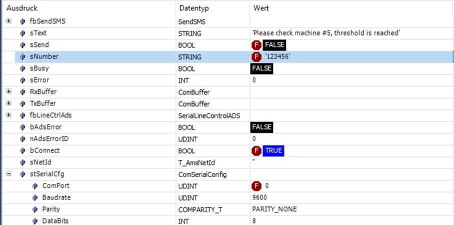

If you want to use the SMS function block (SendSMS) from TwinCAT, you can use the serial interface ttyU0 mentioned above. The TF6340's ADS server (Serial Communication) allows USB devices to be addressed via a virtual serial interface.
Prerequisites:
- TF6340: TwinCAT 3 Serial Communication
- TF6350: TwinCAT 3 SMS/SMTP
In this case, the virtual serial interface can be connected via the TwinCAT 3 function TF6340 (Serial Communication). The TwinCAT 3 function TF6340 must also be installed on the TwinCAT/BSD system. The TwinCAT 3 function TF6350 (SMS/SMTP) then enables SMS to be sent to a recipient using function blocks. A detailed sample of how an SMS can be sent via the LTE stick can be found here: https://infosys.beckhoff.com/content/1033/tf6350_tc3_sms_smtp/373331083.html?id=3466585722444011586
If, for example, the TwinCAT SMS function block is to be used, port "0" must be entered for the interface ttyU0 in the function block.
Fig.2: Example of the use of the SMS function block in TwinCAT 3.
