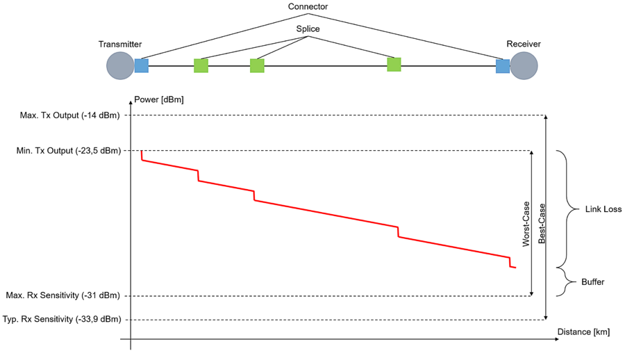

Power and attenuation budget
The power budget specifies the minimum power available between transmitter and receiver. The attenuation budget describes the attenuation between transmitter and receiver due to the three attenuation factors – fiber, connectors and splices – described above.
Transceivers (derived from the words transmitter and receiver) are installed in fiber-optic transmitters and receivers. A transceiver is a combined transmitting and receiving device. The transceiver data sheet usually contains two key values that are required for calculating the power budget. These values are the minimum output power (worst level) of the transmitter and the maximum sensitivity (i.e. lowest received power/level) of the receiver at which it still recognizes signals.
Both values are often specified in the unit decibel milliwatt (dBm). dBm describes the power level in relation to a reference value of 1 mW.
LP[dB] = 10*log10(P1/1 mW)0 dBm then corresponds to a power value of 1 mW, positive dBm values indicate power values >1 mW and negative dBm values indicate power values <1 mW.
For the technical application assessment, the difference between the minimum output power and the maximum sensitivity at the input is therefore regarded as the available power budget as a worst-case assumption:
Leistungsbudget = minimale Ausgangsleistung - maximale EmpfindlichkeitNote: In practice, the power budget is usually higher because the typical transmission power is higher than the minimum. However, this is not always the case.
Cable attenuation results from the attenuation influences described above.
Dämpfungspegel [dB] = Faserverlustdämpfung [dB] + Steckereinfügungsdämpfung [dB] + Spleißeinfügungsdämpfung [dB].
Fig.28: Power and attenuation budgetThe attenuation level must not exceed the power budget, otherwise reliable reception is no longer possible. A reserve as high as >3 dB is recommended (see diagram) to ensure long-term operation for years despite aging effects as sources in the transmitter age and lose power, connectors or splices deteriorate, or connectors become dirty when disconnected for rerouting or testing. If cables are accidentally cut later, a reserve is useful to accommodate splices for reconnection.

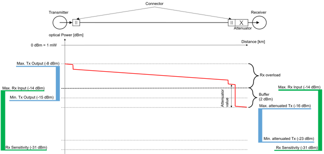

The connection between an EK1521 and a multimode SFP, operated in the CU1521-0020, is now considered as an example:
Fig.29: Performance curve via the EK1521 vs. CU1521-0020 coupling- Left scale: The maximum permanently permissible optical input power of the EK1521 (green: receiver, Rx) is -14 dBm*) and the maximum transmission power of the SFP (blue: transmitter, Tx) is -8 dBm; it is therefore significantly higher. Damage may occur with direct/short connections.
- The signal must therefore be attenuated by at least 6 dB on the path between the transmitter and receiver to prevent the receiver from overloading. It is also advisable to allow for a reserve of around 2 dB.
- Assume a fiber optic cable length of 2 km at 1.25 dB/km, which results in an attenuation of 2.5 dB*). With two connectors of 0.25 dB*) each, 0.5 dB attenuation is added. The attenuation budget of the transmission path is therefore 3 dB.
- With an attenuation budget of 3 dB and a reserve of 2 dB, an attenuator with 5 dB is therefore inserted in the transmitter-receiver path.
Calculation: AttenuationAttenuator = Attenuationnecessary + Attenuationreserve - Attenuationbudget = 6 dB + 2 dB – 3 dB = 5 dB- Right scale: The power ratio between receivable and actually received optical power, taking into account the transmission path and 5 dB attenuator, is as shown: the attenuated incoming transmission power (blue) is now within the permissible power range of the receiver and is therefore OK.

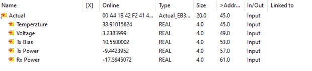

In some devices, the actual transmit and receive power can be viewed using the SFP diagnostic data (DDM)
Fig.30: Real-time display of Tx/Rx power in the CU1521-0020Note: If the line from the Tx port to the Rx port of the SFP is bridged (loopback), the Tx power transmitted can be compared with the Rx power actually received.

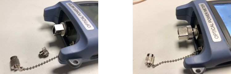

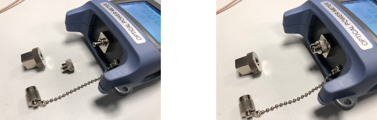

When measuring with an OPM, it is essential to ensure that only the required adapter (FC, SC, …) is screwed to the OPM. If several adapters are screwed above one another to the OPM, the distance between the connector and the detector in the OPM is too large, with the result that lower power values are displayed (greater attenuation than actually exists).
OPM without adapter | OPM with FC adapter screwed on |
OPM with SC adapter screwed on | OPM with FC and SC adapter screwed on - WRONG |
