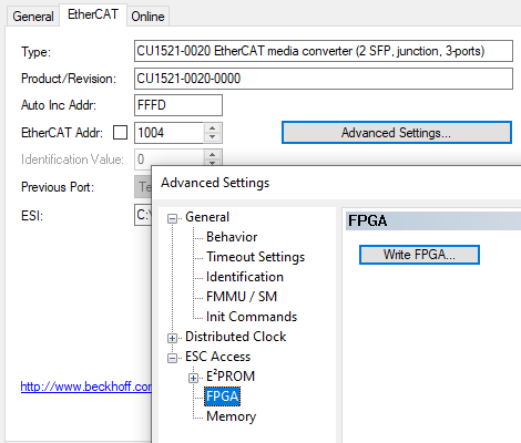

The converter can be updated via *.rpd firmware file.
Firmware compatibility 1:Fig.44: Firmware update by writing to the FPGA with *.rpd file

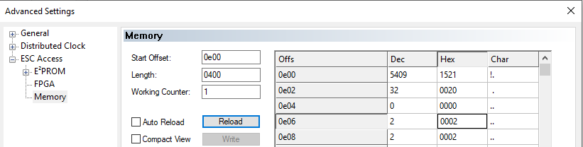

The firmware version is displayed online in register x0E06, here: FW02
Firmware compatibility 2:Fig.45: Display firmware version in register x0E06
