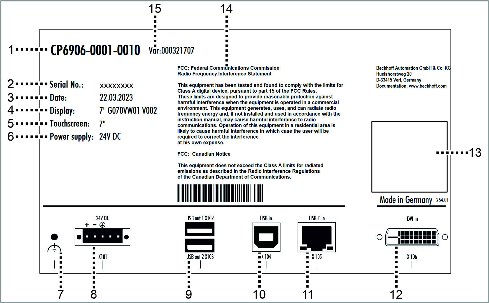

Name plate
The name plate provides information about the control panel equipment. The name plate shown here serves only as an example.
Name plate 1:
Name plate
Legend name plate CP6906-0001-0010
No.
1
Model: The last four digits indicate the device generation.
2
Serial number (BTN)
3
Date of manufacture
4
Display
5
Touch screen
6
Power supply: 24 VDC, NEC class 2
7
Grounding bolt for functional earthing of the control panel
8
Connection of the power supply and protective earth of the control panel (X101)
9
USB output (X102, X103)
10
USB input (X104)
11
USB Extended Interface (X105)
12
DVI Extended interface (X106)
13
Symbols
Note: Here are the symbols applicable to the device such as CE, EAC, UKCA, Name plate 2:. The approvals of your device can be found on the name plate and in chapter 9.2 Approvals.
14
FCC approval
15
Variant number: commercial number of the order code including ordering options
