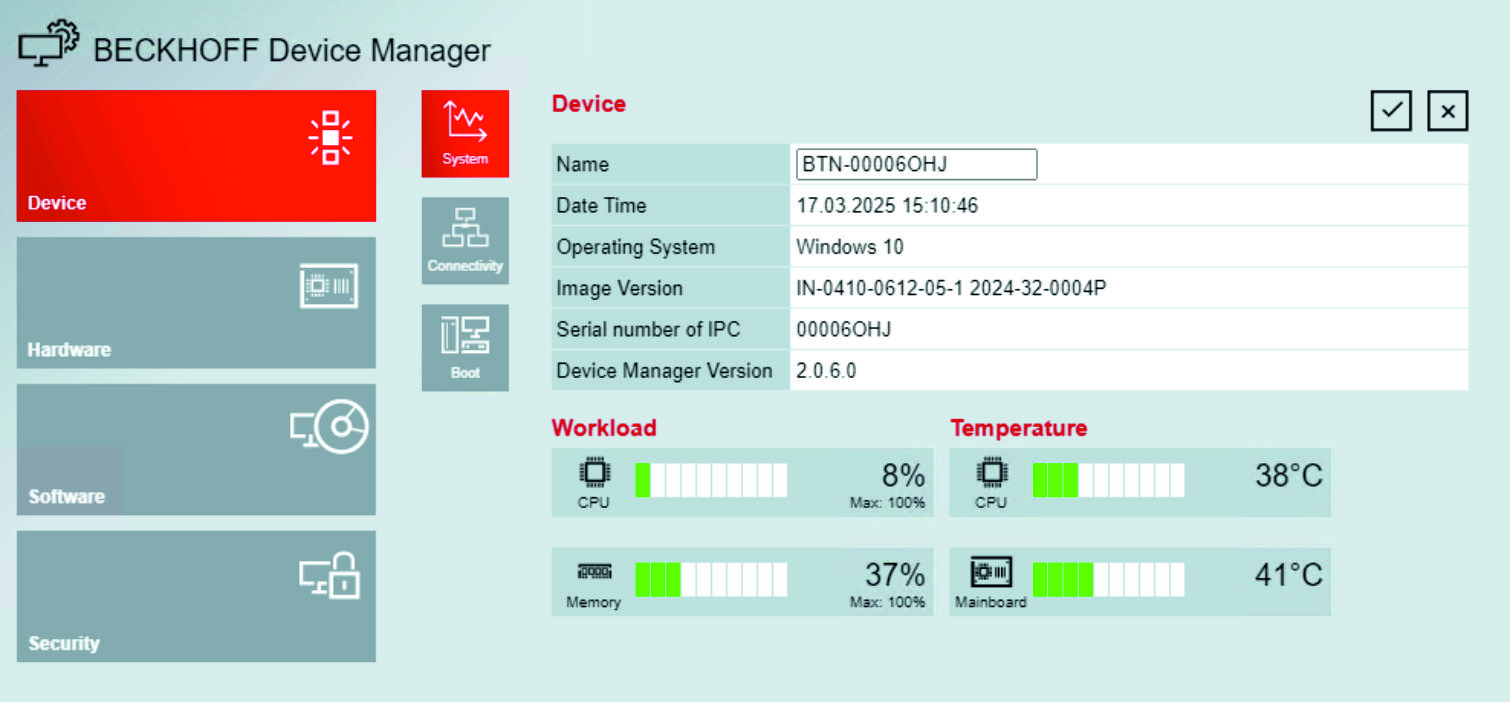

The Beckhoff Device Manager enables detailed system diagnostics with uniform secure access to the existing hardware and software components. System data is recorded, analyzed and evaluated during operation. The data helps to detect deviations at an early stage and prevent device downtimes.
The user interface screenshots shown in this chapter are examples only and do not represent the actual state of your device.

First start of Beckhoff Device Manager
When your device is booted for the first time, the Beckhoff Device Manager also starts automatically for the first time. The Security Wizard opens. It informs you that you should reset the default password set by Beckhoff. Proceed as follows:
- 1. Click Next on the Security Wizard start page.
 - This will take you to the Change Passwords page:
 - 2. Enter the access data of the Device Manager on delivery.
 - 3. Choose a secure new password. Instructions for choosing a secure password are given below.
 - 4. Confirm the changes by clicking on the tick in the red box on the right.
 - 5. Exit the Security Wizard.
- You have reached the Device Manager start page.
Fig.19: Beckhoff Device Manager – Start pageContinue to navigate in the menu and to configure the device. Note that modifications only become active once they have been confirmed.
