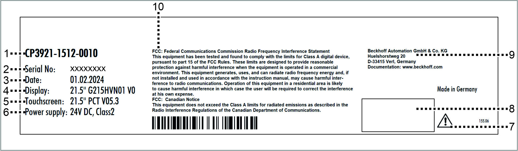

Name plate
The name plate provides information about the control panel equipment. The name plate shown here serves only as an example.
Name plate 1:Fig.14: Name plate
Legend name plate
No.
1
Model: the last four digits indicate the product version.
2
Serial number (BTN)
3
Date of manufacture
4
Display
5
Touch screen
6
Power supply: 24 VDC, NEC class 2
7
Note: be sure to read the device manual.
8
Symbols
Note: Here are the symbols applicable to the device such as CE, EAC, UKCA, Name plate 2:. The approvals of your device can be found on the name plate and in chapter 9.2 Approvals.
9
Address of the vendor
10
FCC approval
