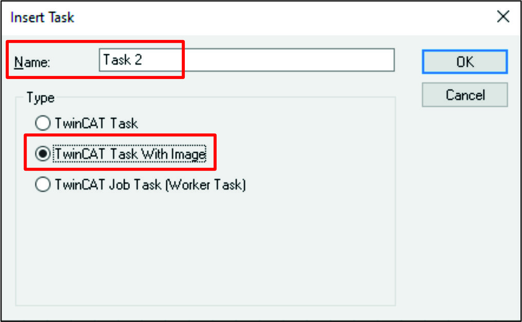

2. Give the task a name and select the TwinCAT Task With Image option.
I/O task linking 2:

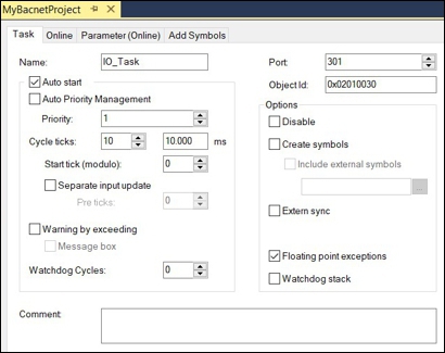

3. Accept the default values for the task.
I/O task linking 3:

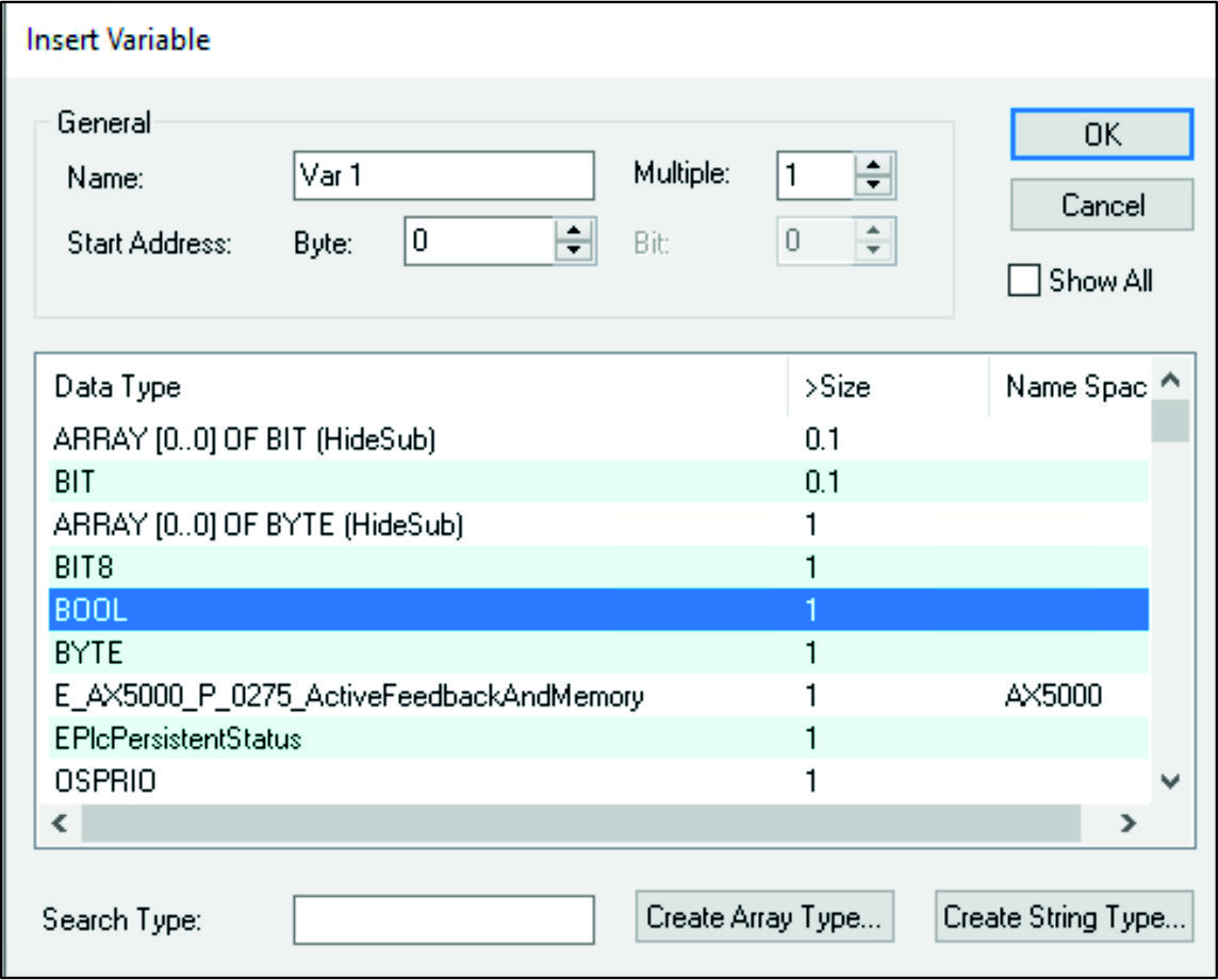

5. Create a BOOL variable with a size of one byte.
I/O task linking 5:

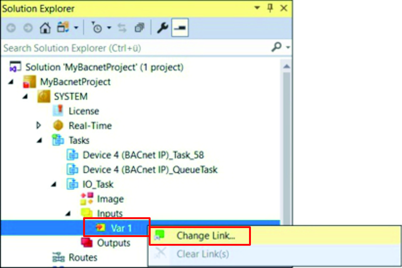

6. Link the BOOL variable to the EtherCAT device.
7. To do this, right-click on the created BOOL variable in the tree view on the left, then click Change Link.
I/O task linking 6:
