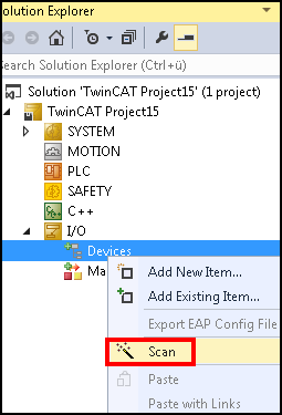

2. Click I/O on the left in the tree view, and then right-click Devices.

3. In the context menu click Scan.
TwinCAT System Manager connection 2:
Scan device
