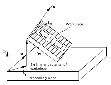

ACS serves to compensate for slanting of the workpiece or of the workpiece pallet. ACS can be selected or cancelled independently of a CS.
Coordinate system for fixture adaptation (ACS) 1:Fig.6: Selection of a coordinate system for fixture adaptation
