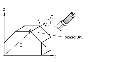

Selection of a coordinate system (CS) 1:
Figure 1-4: Selection of a CS with an offset and rotation
v Offset vector
ϕ Rotation vector
