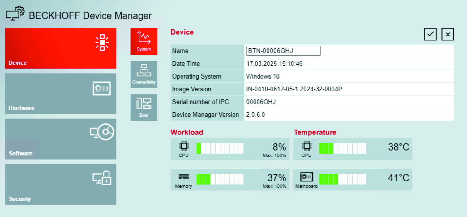

Beckhoff Device Manager 2:
Fig.21: Beckhoff Device Manager – Start page
Continue to navigate in the menu and to configure the device. Note that modifications only become active once they have been confirmed.
