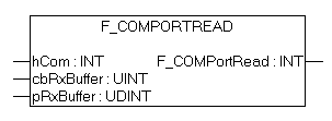

COM Port Read
FUNCTION F_COMPORTREAD
hCom :INT;
cbRxBuffer :UINT;
pRxBuffer :UDINT;
Legend
hCom: is connected with the iHandle of FB_COMPORTOPEN
cbRxBuffer: maximum length of data that can be read.
pRxBuffer: pointer to data to be written with the COM buffer content
Return value |
Meaning |
> 0 |
Number of bytes that is to be copied from the COM buffer into the PLC. |
0x8000 |
Memory overflow |
