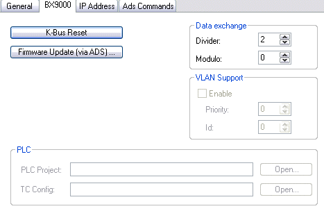

Different PLC cycle times
If the Bus Terminal Controllers used in your system have different cycle times for local PLC processing, you can adjust the time, based on which the higher-level TwinCAT PLC queries each individual Bus Terminal Controller.
Divisor
Use the divisor for this purpose. The divisor used the cycle time of the higher-level TwinCAT PLC, e.g. 10 ms. If the divisor is set to 2, a telegram is sent to the Bus Terminal Controller every 2 x 10 ms, i.e. every 20 ms.
Modulo
Modulo can be used to set the timing for the higher-level TwinCAT PLC.
Example:
Divisor 3, Modulo 0 means a telegram is sent after the first task cycle and then after each third task cycle.
If Modulo is set to 1, a telegram is sent after the second task cycle and then after each third task cycle + 1.
In systems with many Ethernet nodes this enables the number of Ethernet packets to be distributed more evenly, which results in more uniform network load and avoids network load peaks.
