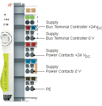

Supply of Bus Terminal Controller and Bus Terminals (Us)
The Bus Terminal Controller requires a supply voltage of 24 VDC.
The BX controller is connected via the upper terminal points labelled 24 V and 0 V. This voltage supplies the Bus Terminal Controller electronics, and the Bus Terminal electronics via the K-bus. It is galvanically separated from the field level voltage.
Power contacts supply (Up)
The bottom six connections with spring-loaded terminals can be used to feed the supply for the peripherals. The spring-loaded terminals are joined in pairs to a power contact. The feed for the power contacts has no connection to the voltage supply for the BX electronics. The design of the feed permits voltages of up to 24 V.
The spring-loaded terminals are designed for wires with cross-sections from 0.08 mm2 to 2.5 mm2.
The assignment in pairs and the electrical connection between feed terminal contacts allows the connection wires to be looped through to various terminal points. The current load from the power contact must not exceed 10 A for long periods. The current carrying capacity between two spring-loaded terminals is identical to that of the connecting wires.
