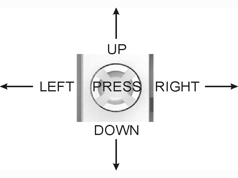

To change into the menu, press the navigation switch for three seconds. The Menu directory appears first.

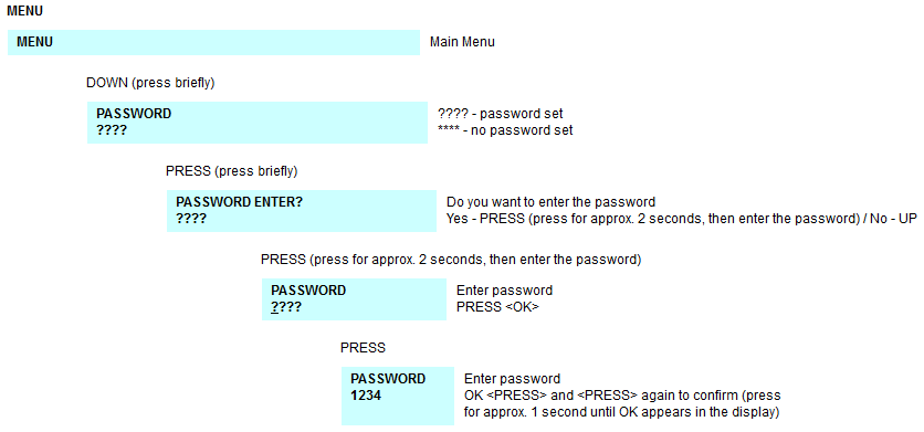

Before settings can be changed, a password has to be set. The password remains stored even during a firmware update and through a reset to the factory settings. If you forget the password, the BX controller will have to be sent in.

Navigation switches of the BX controller
Switch assignment

MENU
Password
**** not set
???? set
See below

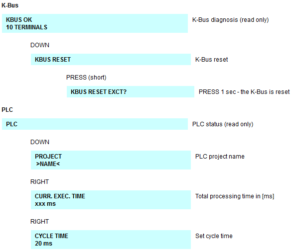

PLC
NAME
>current NAME<
read only
Curr. Exex. Time
>current value<
[ms]
Task time
>current value<
The cycle time can be set if the key is pressed

K-bus
read only
Diagnosis
>current diagnosis<
read only
Number of Bus Terminals
>current value<
read only

Code
The default setting is "****", i.e. no password is active. A password is required for setting parameters.
Menu navigation
Press the navigation switch for three seconds to switch to the Directory menu. Some of the menu items are described below.
