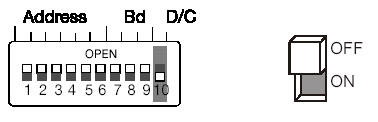

For CANopen communication set DIP switch 10 to "ON".
Lenze frequency converter at SSB 4:
DIP switch
Baud rate DIP switches 7-9
Transfer rate [kbps]
S7
S8
S9
10
ON
ON
OFF
20
ON
OFF
ON
50
OFF
ON
ON
125
OFF
ON
OFF
250
OFF
OFF
ON
500 (default)
OFF
OFF
OFF
1000
ON
OFF
OFF
Lenze frequency converter at SSB 5:
Priority of the DIP switches
DIP switch 6 has the smallest weighting.
Example: Address 3 switches 5 and 6 "ON".
