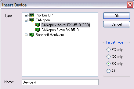

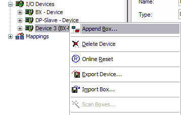

Under I/O devices (left mouse button) a further device can now be appended.
Select the CANopen Master SSB and confirm with OK.

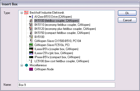

With the left mouse button, a CANopen node can now be selected on the SSB device.
All Beckhoff CAN nodes are available, as well as a general CANopen node for CANopen devices from other manufacturers.
