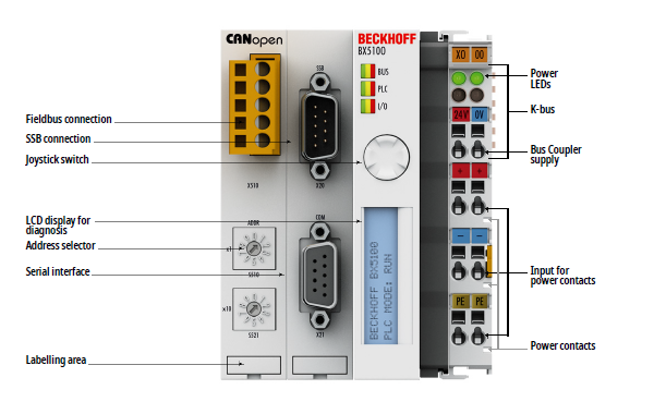

The BX5100 Bus Terminal Controller has a CANopen slave interface. It has automatic baud rate detection up to 1 Mbaud and an address selection switch for address assignment. Up to 16 Tx PDOs and 16 Rx PDOs can be exchanged with the control.
One unit consists of the BX5100 Bus Terminal Controller with up to 64 Bus Terminals and a bus end terminal. With the terminal bus extension system, the connection of up to 255 Bus Terminals is possible. The controller is programmed via the COM1 or via the CANopen interface of the FC510x PC Fieldbus Card.
