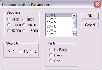

Every Bus Terminal Controller can be programmed via the PC's RS232 interface.
Select the serial interface in TwinCAT PLC Control.
The settings for the serial interface, port number, baud rate etc. are found under Online/Communication parameters in PLC Control.
The Bus Terminal Controller requires the following setting:
- Baud Rate: 9600/19200/38400/57600 baud (automatic baud rate detection)
 - Stop bits: 1
 - Parity: Straight line

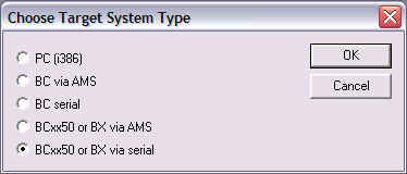

Program transfer via the serial interface and ADS
The Bus Terminal Controller can be programmed via the PC's RS232 interface. Before you can work with the Bus Terminal Controller, TwinCAT must be notified of it (see serial ADS).
Select the ADS connection in TwinCAT PLC Control.
