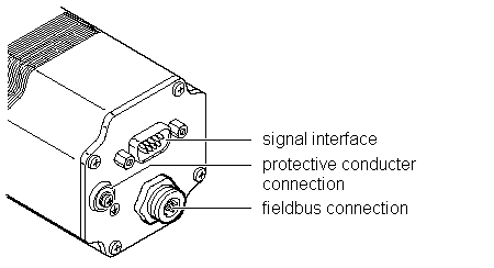

Hardware and interfaces

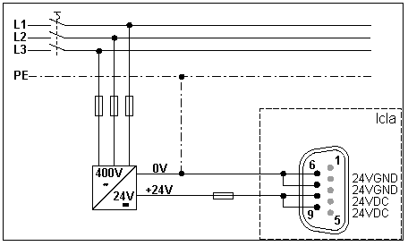

- Signal interface for
- Supply voltage
- Control signals for manual mode
- Connection for emergency stop signal
- Protective conductor connection for earthing via PE bus bar

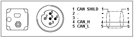

- Fieldbus connection for connecting the fieldbus cable.
If the emergency stop function is not required, connect pin 2 with pin 8 or 9 (24 VDC).

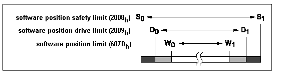

Reference ranges
A valid referencing is defined via three limit switch zones, which have to be within the possible traversing range of the drive. The limit switches protect the drive and the system from damage.
- Working area W0 - W1 for positioning mode.
- Drive area D0 - D1. From ranges D0 - W0 and D1 - W1, the drive can
- only be moved backwards towards the operating range.
- Security area S0 - S1. From areas S0 - D0 and S1 - D1, the drive can only be moved backwards manually.
- CANopen objects - three CANopen objects are used for setting up the limit switches. They contain the position values for the upper and lower range limits.
- Working area limits in software position limit (607Dhex)
- Drive area limits in software position drive limit (2009hex)
- Security area limits in software position safety limit (2008hex)

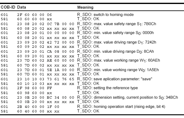

Referencing example
The following listing demonstrates the input of the referencing values. The node address of the positioning drive is set to 01hex.
