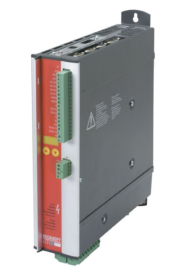

AX2000 description
The following sections are extracts from the AX2000 drive manual. Further information can be found on the internet at http://www.beckhoff.de.

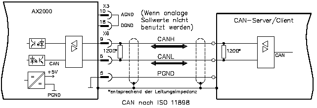

CANopen Interface (X6)
Interface for connection to the CAN bus (default 500 kBaud). The integrated profile is based on the DS301 CANopen communication profile and on the DSP402 drive profile. The following functions are available in combination with the position controller:
jogging with variable speed, reference motion, start travel command, start direct travel command, digital set value specification, data transfer functions and many others.
Detailed information can be found in the CANopen manual. The interface is electrically isolated via an optocoupler and has the same potential as the RS232 interface. The analog set value inputs can still be used. The two interfaces (RS232 and CAN) occupying the same connector (X6) can be split to two connectors via the optional 2 CAN extension card.
