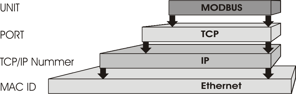

ModbusTCP Protocol
The Ethernet protocol is addressed by means of the MAC-ID. The user does not normally need to be concerned about this address. The IP number has a length of 4 bytes, and must be parameterized by the user on the Bus Coupler and in the application. In ModbusTCP, the TCP port is set to 502. The UNIT can be freely selected under ModbusTCP, and does not have to be configured by the user.
TCP port number
The TCP port number for ModbusTCP has been standardised to 502.
Modbus-Unit
The unit is returned by the slave.
