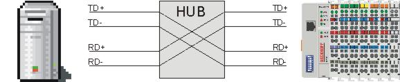

Connection via hub or switch
Connect the PC's network card to the hub/switch using a standard Ethernet cable, and connect the hub, again using a standard Ethernet cable, to the Bus Terminal controller. Connection via a switch is done in the same way.

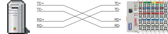

Direct connection between PC with Ethernet card and BC9000
Use a crossover Ethernet cable to connect the PC directly with the Bus Terminal Controller.

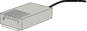

Pin assignment of the RJ45 plug
PIN |
Signal |
Description |
1 |
TD + |
Transmit + |
2 |
TD - |
Transmit - |
3 |
RD + |
Receive + |
4 |
reserved |
5 |
reserved |
6 |
RD - |
Receive - |
7 |
reserved |
8 |
reserved |
