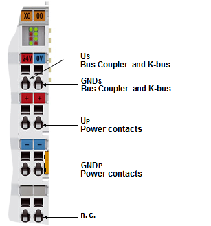

The connection is made by means of the upper spring-loaded terminals labelled Us and GNDs. This supply voltage is used for the electronic components of the Bus Coupler and Bus Terminal Controllers and (via the K-bus) the electronic components of the Bus Terminals. It is galvanically separated from the field level voltage.
BKxx50 and BKxx51 1:Fig.9: Power supply connections for BKxx50 and BKxx51
BKxx50 and BKxx51 2:Fig.10: UL identification
