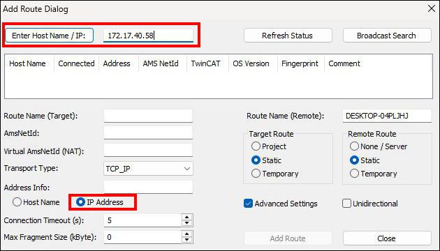

1. If you have the IP address of the Linux® system, enter the IP address of the industrial PC and then press Enter Host Name / IP.
Set up ADS route 1:

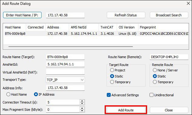

2. Mark the desired industrial PC and click on Add Route
Set up ADS route 2:

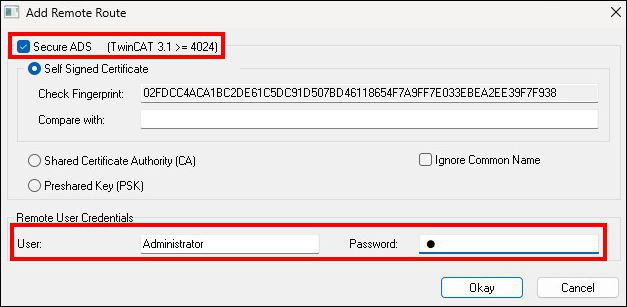

3. Log in as "Administrator" with the password "1". Note that only Secure ADS is possible by default.
Set up ADS route 3:

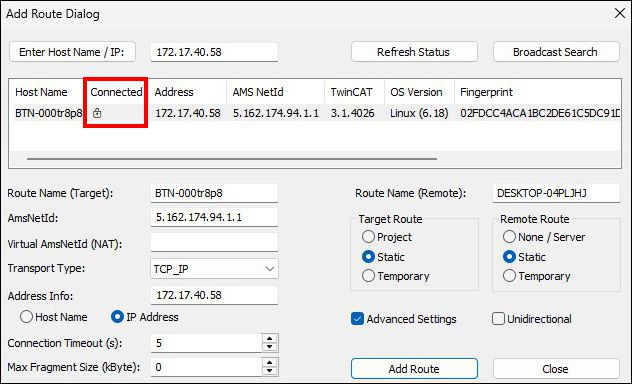

4. A successful connection is indicated by a lock symbol under Connected.
Set up ADS route 4:
