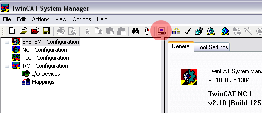

Now start the TwinCAT System Manager and look for the Bus Terminal Controller using the button highlighted in the image or press F8:
Finding the Bus Terminal Controller with the TwinCAT System Manager 1:

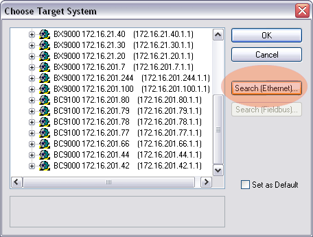

Now look for the Bus Terminal Controller via Ethernet:
Finding the Bus Terminal Controller with the TwinCAT System Manager 2:
Choose Target System

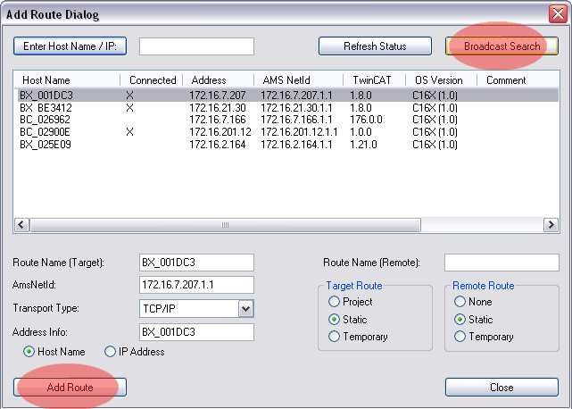

Now find your Bus Terminal Controller via Broadcast Search. If you have several Bus Terminal Controllers in your network, you can distinguish them by their names.
The name consists of "BX_" or "BC_" and the last three bytes of the MAC ID. For the BX9000 the MAC ID can be found on the side, for the Bus Terminal controllers of the BC series on the underside of the housing.
Example: MAC-ID: 00-01-05-00-01D-C3, then the default name is BX_001DC3.
If the Broadcast Search fails to find a device, check the Ethernet connection and the firmware in the controller.
If the Bus Terminal Controller was addressed via DHCP, you can include the Bus Terminal Controller in your connection via the button Add Route in the Host Name dialog.
If the Bus Terminal Controller was addressed manually or via BootP, select the assigned IP address and establish the connection via the button Add Route.
Acknowledge the password query dialog without making an entry. No password is required for Bus Terminal Controllers. Bus Terminal controllers do not offer password support.
Finding the Bus Terminal Controller with the TwinCAT System Manager 3:
Add Route Dialog
