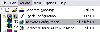

To activate the TwinCAT configuration select Ctrl+Shift+F4 or Activate Configuration.
Activating the TwinCAT configuration
The current configuration is loaded onto the Bus Terminal Controller. The display will show Store Config, and the BUS and I/O LED will flash. Once the configuration is successfully loaded onto Bus Terminal Controller, TwinCAT Config should appear in the display of a BXxx00. The corresponding program can now be transferred to the Bus Terminal Controller (program-download via the fieldbus).
