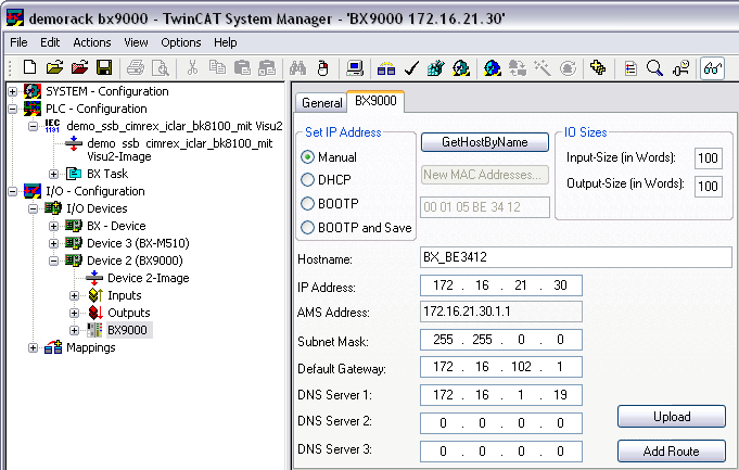

Address Configuration via TwinCAT System Manager
An operable ADS connection is necessary in order to set the IP address through the System Manager. This can be done via Ethernet (see chapter Finding the Bus Terminal Controller with the TwinCAT System Manager).
On the BC9191, switches 1 and 2 of the 2-pin blue DIP switch must be set to ON to enable IP addressing via the System Manager.
The settings made via the System Manager are then applied.
You can read the current settings with Upload. If the Bus Terminal Controller was configured offline, the Add Route button can be used to establish a connection to the Bus Terminal Controller. Edit the required settings, activate the configuration
and restart your Bus Terminal Controller with the green TwinCAT icon (shortcut [Ctrl] [F4]). If the Bus Terminal Controller has been assigned a new IP address, you have to re-enter the new route with the new IP address (see chapter Finding the Bus Terminal Controller with the TwinCAT System Manager).
