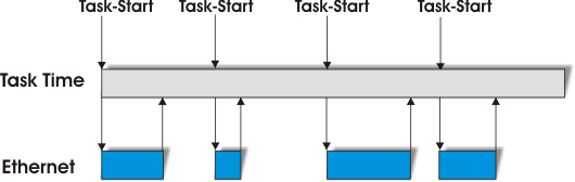

Ideal configuration:

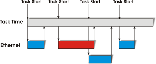

The task time is always longer than the Ethernet propagation delay. An Ethernet telegram is transmitted at the beginning of the task, and it returns it to the PC again after a period of time, tEth. If the time tEth is always smaller than the task time that has been set, the value in the MissedCnt counter remains constant.
If, after the task time has elapsed, an Ethernet telegram has still not arrived at the PC, only reaching it after the next task has started, then TwinCAT will continue to work with the old input data. In addition, the MissedCnt counter is incremented.
This can have the following causes:
- The chosen task time is too short. Set
- 100 ms or more for TCP,
- 20 ms or more for UDP.
- Too many collisions in the network: use switches instead of hubs!
- The bus load is too high: change to 100 Mbaud!
- You are logged in to the BC9000, C900: this consumes additional processor power in the Bus Terminal Controller, which lengthens the response time.
