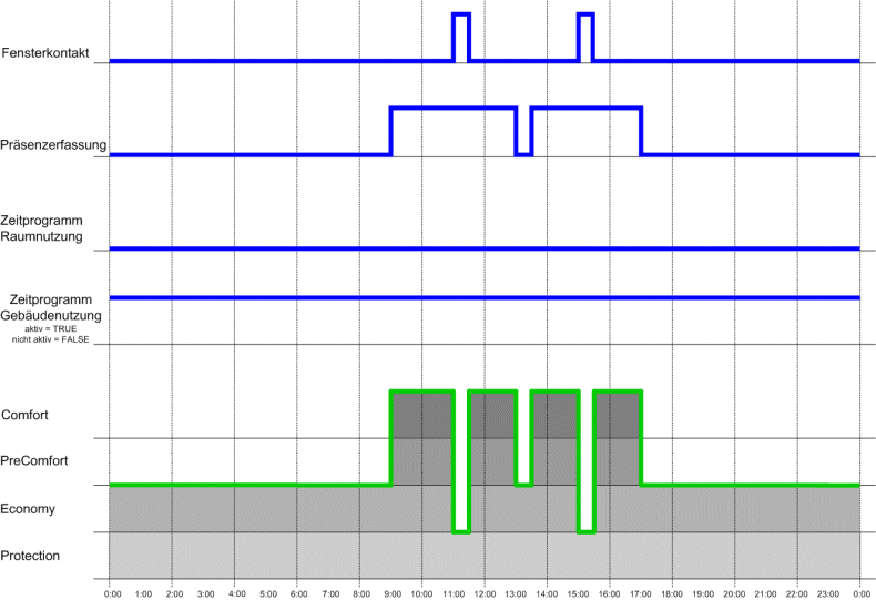

eEnergyLevel_AUTO_I
Automatic mode I means that in this operation mode it is only possible to switch to the next higher energy level if the lower energy levels are already TRUE. In this operation mode the states of the inputs bProtection, bEconomy, bPreComfort and bComfort are evaluated for the selection of the energy level. Please see diagram.
E_BC9191EnergyLevel 1:
Assignment of the energy level in automatic mode-I
eEnergyLevel_Protection
In this operation mode, which can be manually set by the building management level, the room/zone/area is maintained in a minimum energy state. This operation mode is purely a Protection mode.
eEnergyLevel_Economy
In this operation mode, which can be manually set by the building management level, the room/zone/area is maintained in economy mode. This operation mode is to be set in case of lengthy periods of absence or at night.
eEnergyLevel_PreComfort
In this operation mode, which can be manually set by the building management level, the room/zone/area is maintained in Pre-comfort mode. This operation mode is to be set in case of short periods of absence.
eEnergyLevel_Comfort
In this operation mode, which can be manually set by the building management level, the room/zone/area is maintained in comfort mode. This operation mode is to be set in the case of presence.
eEnergyLevel_AUTO_II
Automatic mode II means that in this operation mode the energy level switches directly from the Protection, Economy or PreComfort energy level to the Comfort energy level on recognition of presence. Please see diagram.
E_BC9191EnergyLevel 2:
Assignment of the energy level in automatic mode-II
