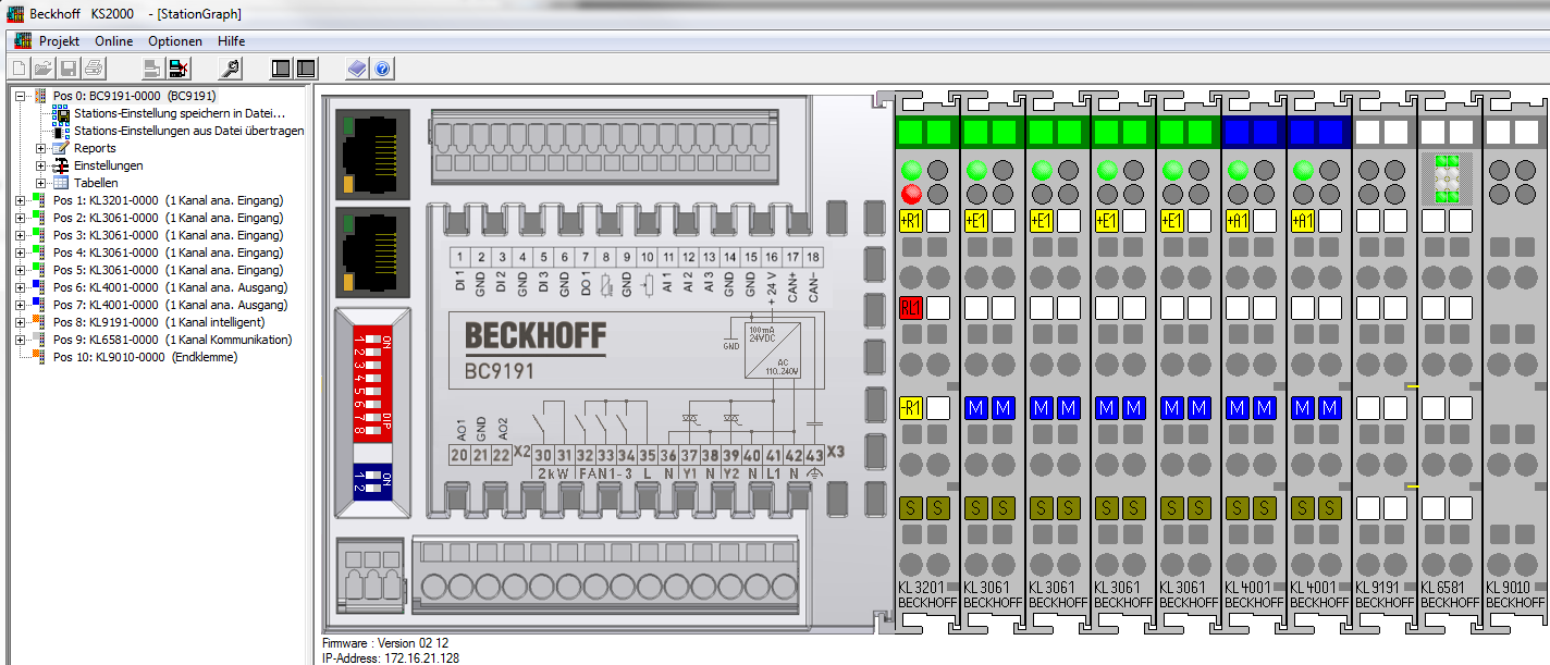

Configuration of the integrated inputs and outputs
The integrated inputs and outputs, as well as the sub-bus of the BC9191, are displayed as normal terminals for configuration in the KS2000 configuration software.
The configuration is then performed in the same way as for the respective standard Bus Terminal.
Configuration of the integrated inputs and outputs 1:
Display of the BC9191 in the KS2000 software
