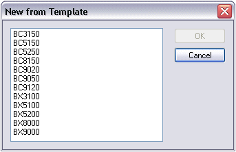

In order to configure a Bus Terminal Controller of the BCxx50, BCxx20, BXxx00 or BC9191 series, create a BX file in the System Manager. To simplify matters, files for the basic units have already been prepared. Open the corresponding Bus Terminal Controller with New from Template.
Creating a TwinCAT configuration
Select the corresponding Bus Terminal Controller.
Selecting the Bus Terminal Controller
