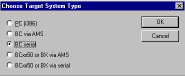

Select the serial interface in TwinCAT PLC Control.

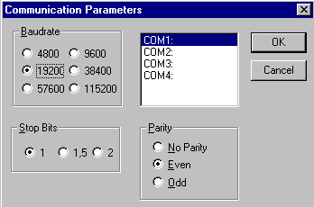

The settings for the serial interface, port number, baud rate etc. are found under Online/Communication parameters in PLC Control. The Bus Terminal Controller requires the following setting:
Baud Rate: 19200
Stop bits: 1
Parity: even
