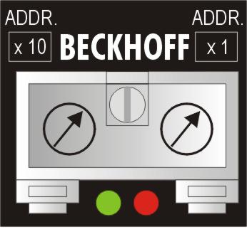

The PROFIBUS address must be set using the two rotary selection switches behind the transparent cover. The default setting is 11. Any address is permitted, but each address may only be used once within the network. The address can be modified when the Fieldbus Box (Bus Coupler) is switched off. Release the cover (Fieldbus Box only) and set the switches to the required position using a screwdriver. Make sure that the switches engage properly. The change in address is active as soon as the device is switched on.
Fieldbus Box address
The switch on the left represents the tens, while that on the right represents the units.
Bus Coupler address
The lower switch S311 represents the tens, while the upper switch S310 represents the unit.
