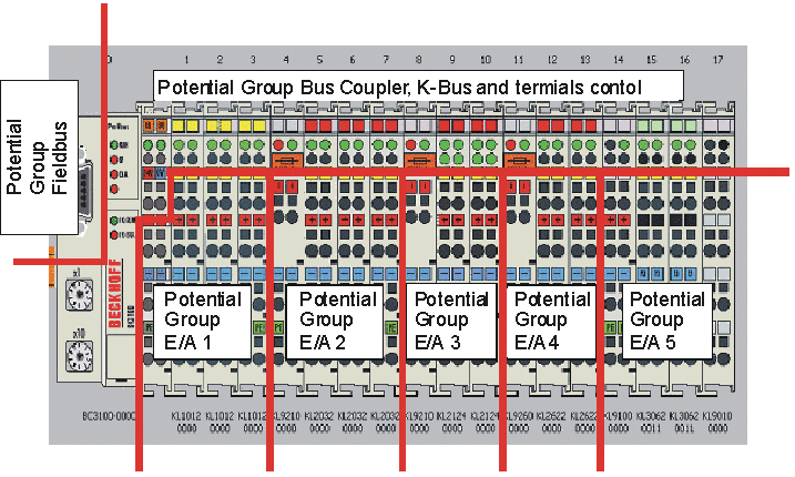

A Beckhoff Bus Terminal block usually has three different potential groups:
- The fieldbus interface is electrically isolated (except for individual Low Cost couplers) and forms the first potential group.
 - Bus Coupler / Bus Terminal Controller logic, K-bus and terminal logic form a second electrically isolated potential group.
 - The inputs and outputs are supplied via the power contacts and form further potential groups.
Groups of I/O terminals can be consolidated to further potential groups via potential supply terminals or separation terminals.
