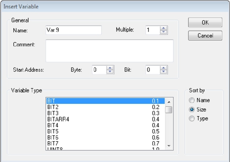

Create the process data as follows:
- 1. In the tree view, right-click on the inputs or outputs.
- 2. In the context menu click on Insert Variable.
The Insert Variable window appears. - 3. Find the required variable type and click OK.
- You have successfully created process data. The new variable is shown in the tree view on the left. In this way you can add further process data or variables for the EtherCAT slave.
