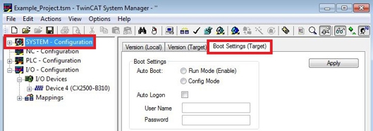

- 1. In the tree view on the left click on SYSTEM – Configuration.
- 2. Click on the Boot Settings (Target) tab.

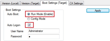

- 3. Under Boot Settings select the option Run Mode (Enable) and tick the Auto Logon checkbox.
- 4. Enter the user name and password for the CX in the User Name and Password fields.
- 5. Click on Apply.
The Logon Information window appears.
- 6. Re-enter the user name and the password and click OK.

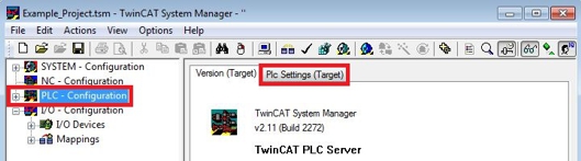

- 7. In the tree view on the left click on PLC – Configuration, then on the PLC Settings (Target) tab.

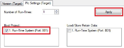

- 8. Select the Start PLC under Boot Project and click on Apply.

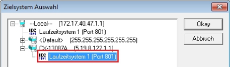

- 10. In the menu bar at the top click on Online, and then on Choose Runtime System.
- 11. Select the runtime system from the CX and click on OK.
