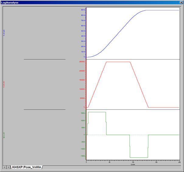

Notes on tracing possibilities 1:
Trace of an unfiltered movement with a linear slope

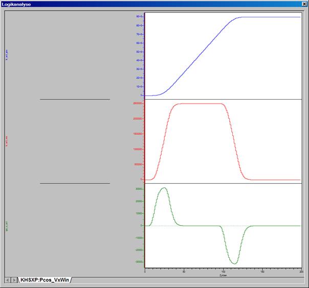

Notes on tracing possibilities 2:
Trace of the filtered movement with double acceleration

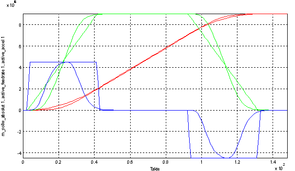

Notes on tracing possibilities 3:
Superpositioning of both traces (note: for technical reasons, the acceleration is not true to scale here!).
