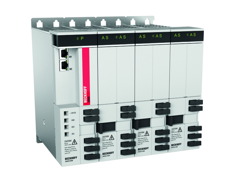

AX8000 Multi-axis servo system
Optionally with power supply module
- AX8620-0000 Power supply module 20 A DC
- AX8640-0000 Power supply module 40 A DC
- AX8525-0000 Combination module 80 A DC
- AX8540-0000 Combination module 80 A DC

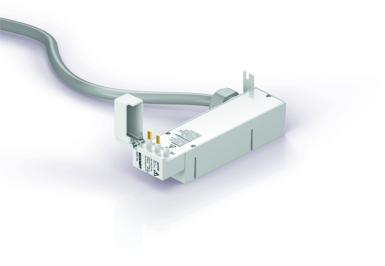

DC link integration
depending on the power supply module used:
- AX8620: ZK4875-9004-xxxx DC link connection cable
- AX8640: ZK4875-9007-xxxx DC link connection cable
- AX8525 / AX8540: Two-wire connection directly from the combination module

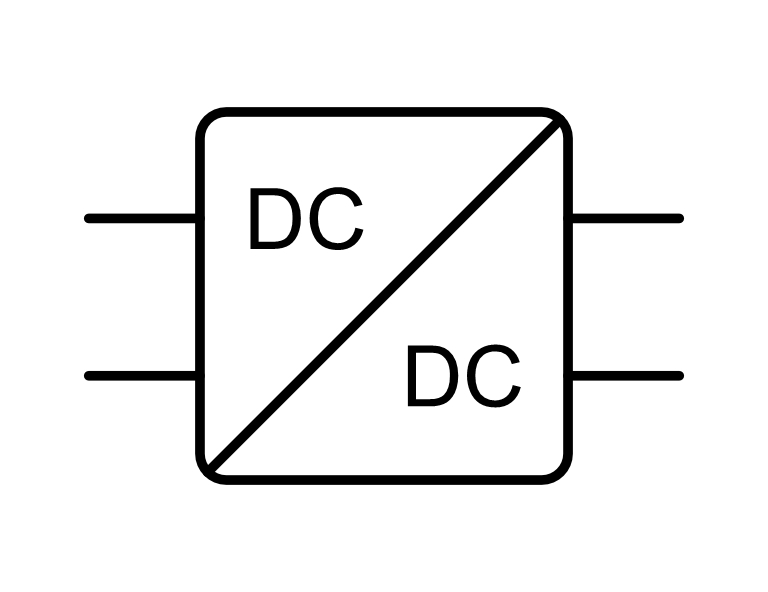

DC/DC Converter
Input voltage: 320…848 V DC
Output voltage: 24 V DC
e.g. Siemens SITOP PSU400M
