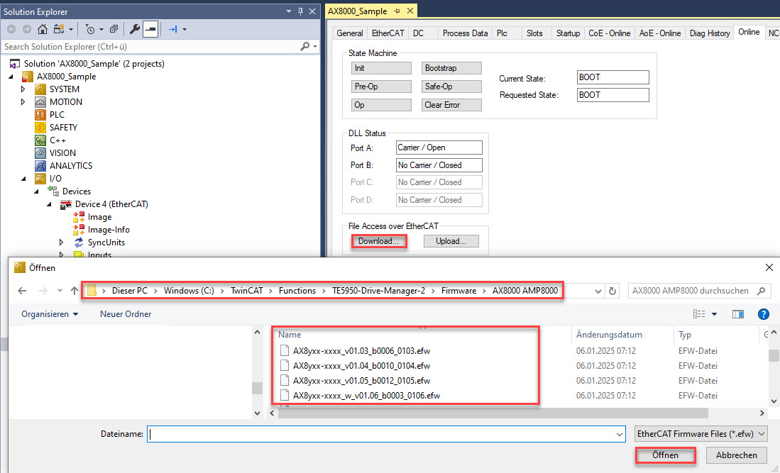

Request device EtherCAT state [bootstrap]

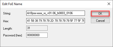

Firmware update | Firmware version V1.07 to V1.07 or higher 2:
Download the required firmware version via (FoE) download
